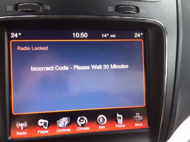

  • Dear All,
    I just wanted to inform everyone, that I solved my problem yesterday evening! It was absolutely easy!
    Well, before I went to switch off the battery for at least 30 minutes, I said, let's take a try to update the firmware again! This idea came, because after the first update and restart the car recognized the usb again, and asked me for another update.
    So I took the usb drive, put it in the car, and again it resolved that there is an update.
    Notified me what version is in the car and what is on the usb. There were the same. Ok, I said YES, update.
    It started as normally, checking, then progressbar with copying files. But this time this progress bar finished just in some seconds, it recognized, that those files are already there.
    The car asked for a new restart, then everything went fine. No PIN question! Everything works just fine!
    Now, what was the point here?
    Well, when I tried the update at first, I did not switch the car to RUN mode! I left it in ACC mode only. This means not all the units are under power, just a few really required!
    So after the restart when the unit asked for identity data from the car, those units were offline, so it behaved like when the unit is moved to another car.
    Maybe the power off will be also helped, because after a full restart this handshaking should take place again.
    But I think a second update in RUN mode is much easier thing. And it really solved this issue. Hopefully!
    Thanks for Your help and kindness here!

  • But I think a second update in RUN mode is much easier thing. And it really solved this issue. Hopefully!
    For sure, it will. When i downloaded an update on my Jeep, some instruktions came with it. There was written, that the update may be done only in RUN mode! So I thought this is known and I did not ask for it.
