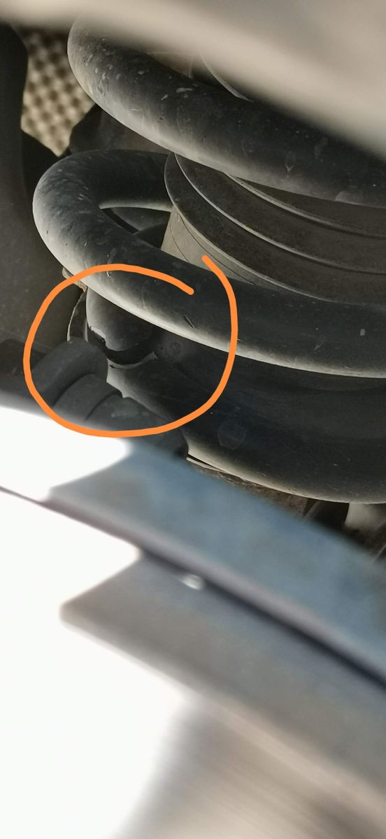

Can you please help me determine the correct PN for the rear spring for Freemont 3C4PFBCY6ET221638?
Item 11 does not apply to this VIN.
Which PN should be the right one?
the right is broken Hinterachsfeder

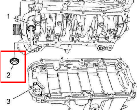

Picture of the seal of the oil pump.
Hi, anyone had this issue of loosing sudently the oil pressure?
The seal ring between oil pump and oil strainer is getting old and sudently the oil pressure is getting to zero!
This issue is known very well on the Opel Insignia 2.0 multijet, the engine is the 2.0 mjltijet used by all FPT equiped models.
The oil pan integrates the oil strainer. And the seal ring is the element conecting the strainer to the oil pump.
The issue is known aproximative arround 200000km.

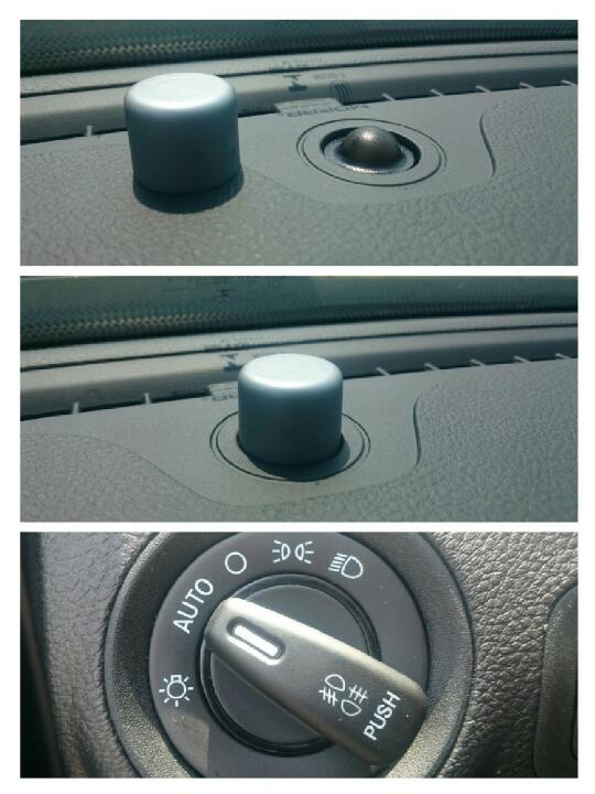

Hat jemand getestet, um den Fernstart vom Körpercomputer aus zu aktivieren?
funktioniert wirklich? ohne zusätzliche Hardware?
Sie verwendeten den Originalschlüssel und fügten einen weiteren Knopf hinzu (Löten).
ich habe das gerade auf youtube gesehen und sieht gut aus!
check this sollution:
My version: see attached picture.
